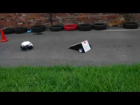

                      I've not really had a chance to build the weapon owing to work commitments and building Shu! but I did find a bit of time to have a test match with The Honey Badger 2.0 vs The Honey Badger 1.0, taking place in a fenced off area at a community centre me and my brother go to.
                      The whole point of doing this was to see if there were any weak spots on the 2.0 iteration and it did just that. Driving it on the tarmac, the wires connecting to the motors kept on falling off (which was an issue on the 1.0 iteration and I am sure caused the carnage at Grantham) and it kept on grounding out, which I am putting down to the motor mounts mounting the motors (and thus the wheels) too high off of the ground.
                      We had three matches and The Honey Badger 2.0 lost twice and drew once, both times due to the thing grounding out. I know the arena is going to be much more flat than this but debris could spell disaster as it is. New mounts are a must and soldering of some XT60 connectors for the motors.
                      The video is of the third fight. I was in control of The Honey Badger 1.0 with my brother in control of The Honey Badger 2.0. The camber of the driveway meant there was a gutter thing along the edge that the 1.0 variant seemed to like getting stuck in.
