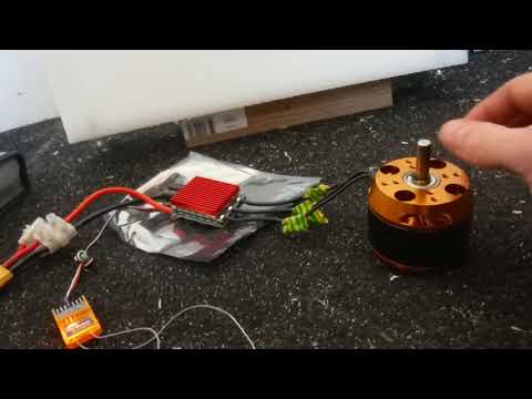

                  • Well... one of them is kind of working...
                    Perhaps if anyone could advise me as to why the motor is acting the way they are, I'd be most grateful
                    • Have I just replied to this same issue on Facebook?
                      • I wouldn't have thought so, I don't have a Facebook account of any variety.
                        EDIT: Looking at a video which is kind of similar, I think I have a bad connection somewhere, which is likely given how pants my soldering is (despite doing plenty of this at Manchester with Chris from ARC Robotics :P). Will dig further.
                        • These look like the RedBrick 125A ESCs. You mention using a different hex file, is this labelled rb70a3?
                          • They are 100A v2 Redbricks, so using the rb70a2.hex file.I need to figure out how to use the kkmulticopter tool to reprogram it to give me reverse. I know it is a boolean switch from 0 to 1 but I can't figure out (yet) how to get the code to load.
                            • Ah, OK. Do you get the three audible beeps at different frequencies on powering up the ESC? I couldn't really hear in the video. If you only get two, the one phase is missing and that's the difference in V2/V3 pinout. I had the same at first on the 125A.
                              • I get 3 beeps when the power is turned on and signal is acquired.
