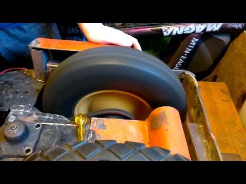

Euan is right the wheels cant slip sideways as they are very tight between
the bearing hubs, the wheels dont have bearings themselves, they sit on
the spindle 22mm thick and are bolted to it and the sprocket is welded to
the spindle shaft.
