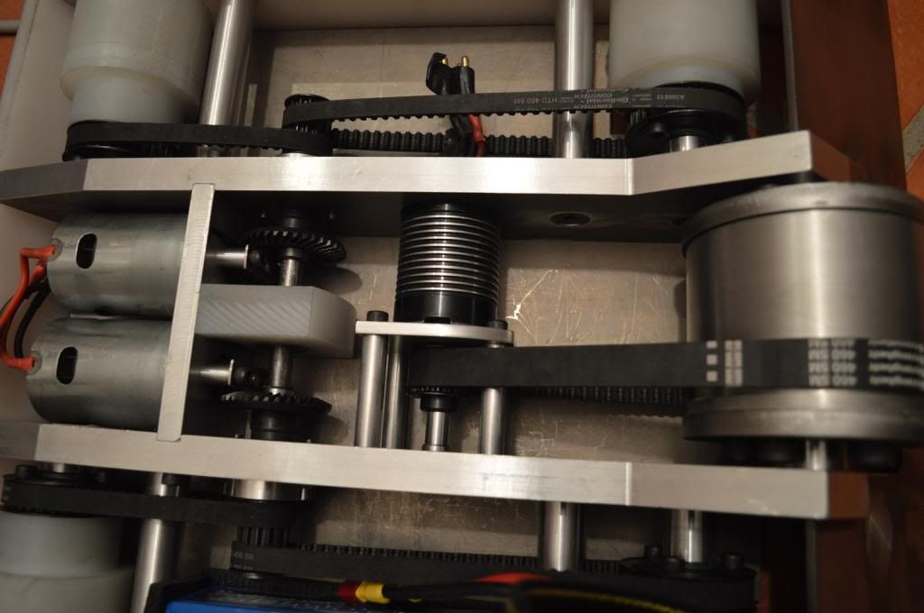

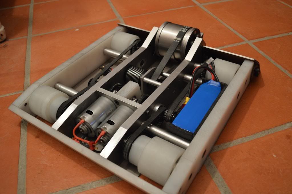

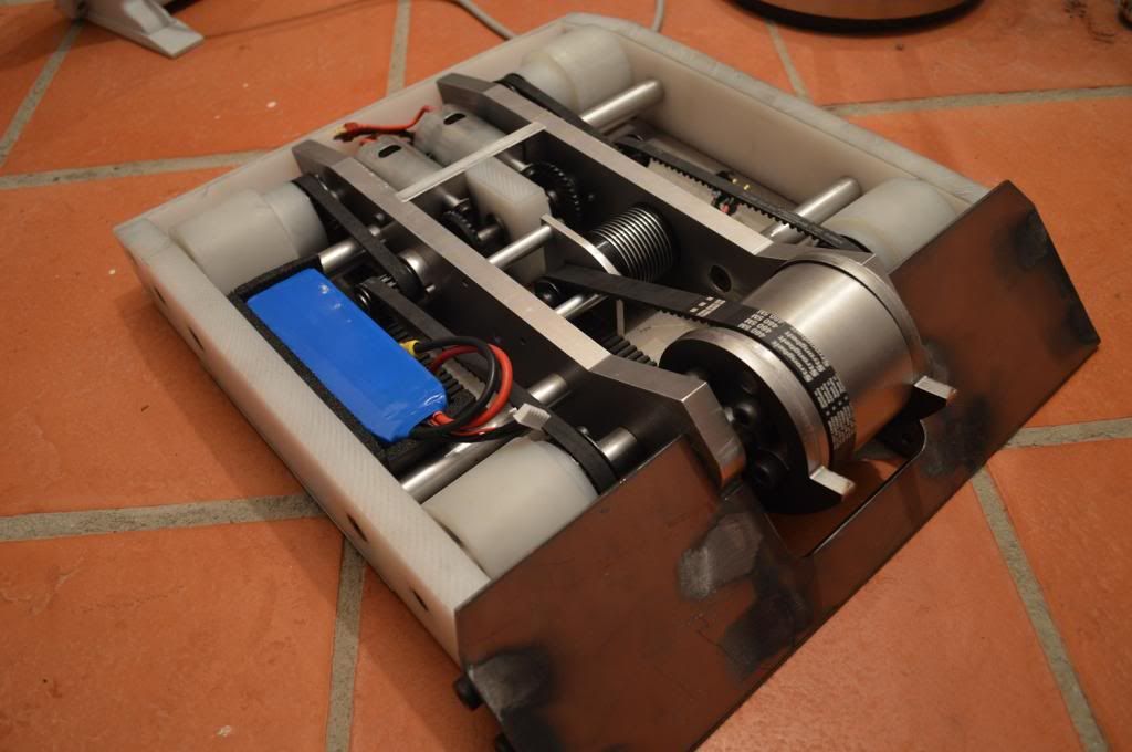

                        • Thanks guys. I'm going to skim the belt groove down a touch (I can't go much as the disc pins are just beneath) which will hopefully make the belt a little less tight.
                          I have started with the wedge now, it's in place here, tomorrow I'll make up all of the spacers (and change the outer bolts, those ones aren't final) and grind the leading edge. Still got tons to do!
                          Some pics, please excuse how grubby it all is, white HDPE is the ultimate in making workshop crap visible.
                          Thanks again to Mario for organising and welding up the wedge.
