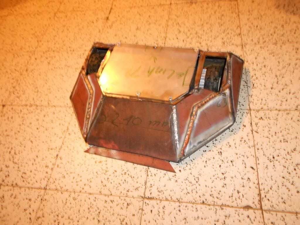

                              • HardWired II lives!
                                Pretty major change-up this late in proceedings, but it's definitely all for the better. Would just like to give an absolutely huge thanks to Mario for all the help here, since HardWired II would be a very different machine without the help, and not in a good way either. The HDPE chassis has distorted even more, so if I'd have stuck with it, it'd be unusable by this point anyway. So, here's the new look HardWired II!
                                Made entirely of Hardox, thicker on the scoop at the front (I think about 6mm, but it's late so I may be mis-quoting!) so it should be able to stand up to even the scariest of spinners, which are becoming more and more abundant by the year, worryingly... Of course, it still needs paint, and I'm going to be putting slightly thicker bike tread on it to give me a little more ground clearance on the top - perhaps adding some little spikes on the front to catch other machines, Bonx style, but they're all just minor things now. Link just needs placing in there (on the top plate I think) and the LED needs wiring into my system too, and we should be good to go!
                                The electronics are all still the same, speed 900-size motors running on 4S using TZ85As. I can't remember the ratios to the wheels but in all it should be pretty nippy across the arena. Just got to get practising now, and getting everything else ready for the champs like the charging cradle and all that.
