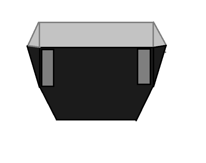

                    Well, sort of. Basically, the original idea was to go 4WD with a 4-bar lifter, which would have made the machine essentially a Featherweight Storm II, missing a wheel either side complete with Hardox scoop. Plans have since changed, and now I've changed to two wheel drive (beefy motors) with the same hardox scoop, both of which look pretty great (thanks, Maddox!)
                    In a nutshell, it's out with the 4WD for now, and in with a 2WD rambot, with most likely a back hinged scoop, or perhaps a small 4-bar IF I can fit it in there. If not then I'll re-evaluate to try and get some kind of lifter in there, for the simple fact that I think the lifter would work excellently in tandem with the push if I could work it correctly.
                    Here's a very quick paint image of what I had planned, http://i1355.photobucket.com/albums/...psf5abfbc7.png,
                    I've not ironed out the creases yet, nor really put any major thought behind it - I'm just waiting until I've got all my materials and parts here so I can cardboard mock-up the lot and see what I'm working with so that I don't make it massively underweight (not likely) or overweight or make everything the wrong scale...
