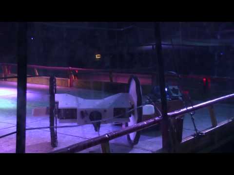

                        • A video of one of the fights with Gabriel at Colchester
                          • I love how its almost as big as major damage!
                            Looks quite lightweight though but I guess the middle section is just dense so very heavy.
                            It's just a shame that it doesn't seem to damage anything, I preferred it when saint had that massive hammer thing on it.
                            • It's huge!
                              • Still think i won that fight
