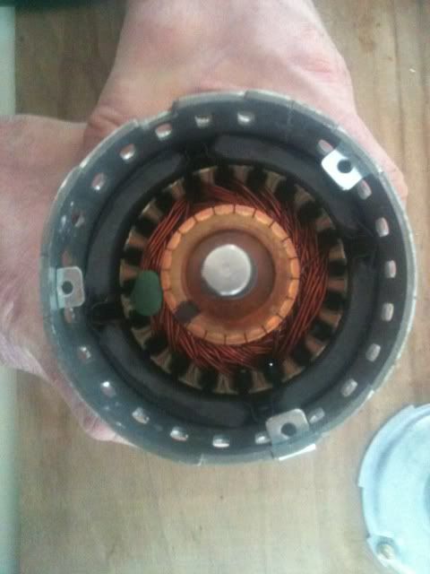

                    Hi,
                    I have bought a pair of Bosch 400s for a hw, I know I am suppose to modify the magnets but I can't figure out what I am supposed to do- I read that you have to glue in te magnets and rotate them so that it goes equally fast in both directions but I can't figure out how to rotate the magnets? Also should I be able to just pull out the shaft in the middle with the coil on it- I think you have to to take out the magnets?
                    Here is a picture:
                    Thanks,
                    Max
                    • Re: Team MedBots
                      You can pull out the rotor, but it requires a lot of force.
                      To get the magnets in the neutral position, you'll have to remove magnets and clips. You'll see that the clips have a nook that fits in a slot in the can. And that that slot has 2 brothers Now the nook will be in a lot on the side. By using the one in the middle, you will have put the magnets in neutral position.
                      To upgrade the motor to RW capabilities.
                      Using a strong glue- araldite was one of the choises- to keep the magnets in place.
                      Remove the fan.
                      Weld the front plate.
                      And keep in mind, overvolting to 24V will cook the motor, unless you have a massive reduction ratio.

                        Thanks mario,
                        Is it really necessary to take off the fan or weld on the end cap?
                        Also I think I read you can use a piece of dowel instead of glueing in the magnets, is that correct?
                        • Re: Team MedBots

                          • Re: Team MedBots
                            Welding the cap ain't needed if you support the can itself. But I would do it whatsoever. That's because welding is plain fun for me.
                            Removing the fan ain't needed either. But it removes a point of failure.
                            Glueing the magnets. If you use the merlon trick, it's less needed, but still recommended. Just using dowels won't save the motor from magnets that shake lose the nook on the springs and start rotating in the can.
                            And yes Gary, creative minds have added copper to Bosches. King Buxton and Tornado spring to mind.
                            • Re: Team MedBots
                              What is the extra copper for?
                              • Re: Team MedBots
                                More turns, more resistance, less current draw but same torque and speed at same voltage. Allows more over volty goodness due to less current draw.
                                Or if you somehow couldn't over volt but your batteries and speedo can take the extra current you could use parallel strands of wire. Same number of turns, lower resistance, more current draw, more torque same speed at same voltage.
