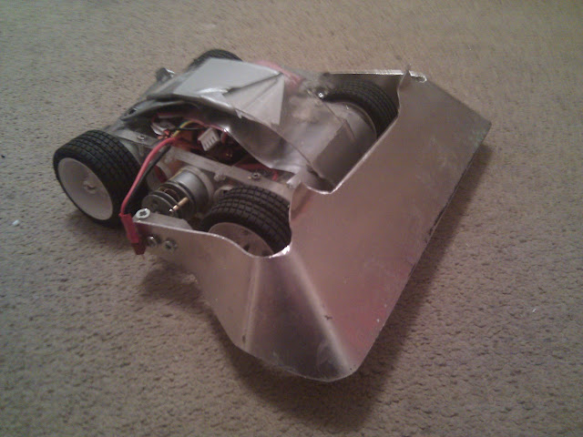

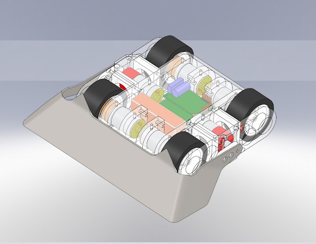

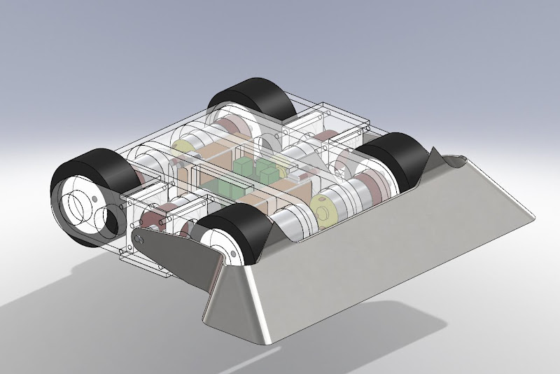

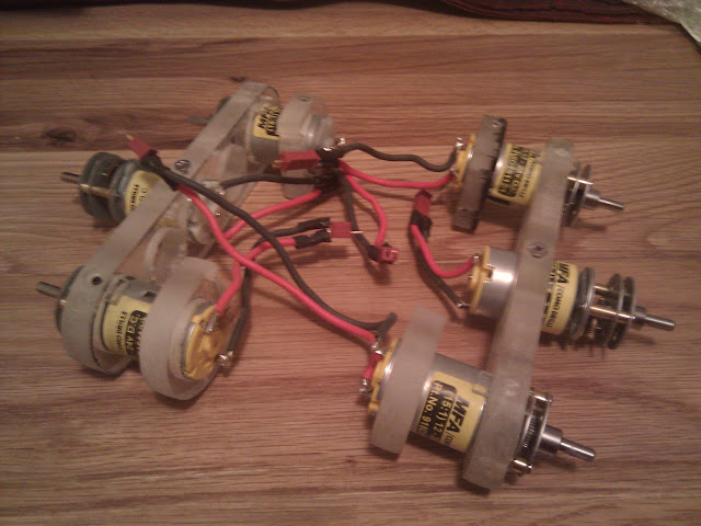

They're both going to be fairly similar to Ewan's robot's Fractal and Flux, but without the fun of tracks. No names at the moment, I'm hoping I'll get an idea whilst I'm building them. At the moment I've got the drive train working for the feather but no idea about the frame or weapon layout. I've got a rough layout of the beetle:
Component list:
3s 1000mAh lipo from Giantcod
4 x RE280 15:1 drive motors from technobots
2 x RE280 250:1 weapon motors from technobots
tamiya wheels
sabertooth dual 5A for drive
Polulu 15A for the weapon
Has anybody got experience with those components?
CAD drawings next
