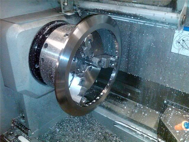

      kennys done abit more;
      just needs the profile doing then its ready for a week in an oven at 510 degrees followed by an acid pickle

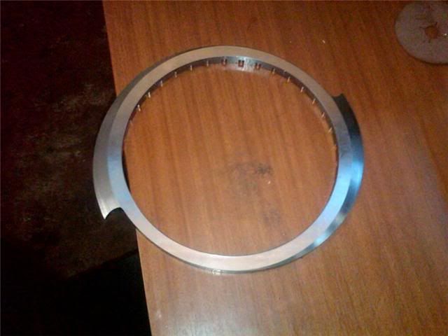

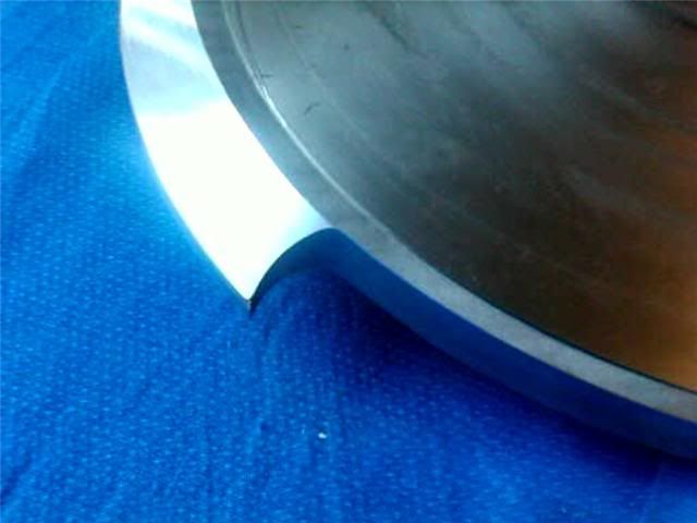

            Also kennys finnished profiling my disc now just needs 360 engraving on it and nitride coating;
            • #66
              Re: 360 - mini hypnodisc
              Looks good! Whats the weight now?
              How deep is 360 being engraved? want it as shallow as possible so you dont loose extra weight
              • #67
                the engraving will be done 0.5mm deep with a small ballnose cutter so will have a nice raduis
                  Shiny
