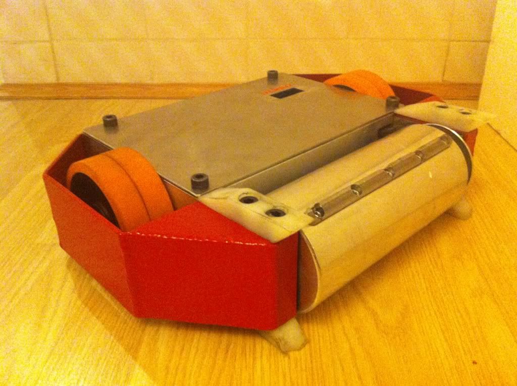

          mr_turbulence, you made a great work, 720 looks great!
          Which is the diameter of the shaft of the drum? what is the type of bearings that you using?
          I'm anxious to can fight against 720 and Drumroll at same time =P
          • Re: 360 - mini hypnodisc
            A drum-off! Will be awesome.
              Thanks Guilherme, just finnished it today actually;
              armour TIG welded;
              And painted;
              The shaft is 20mm solid silver steel, which is then key'd into each bulkhead 15mm deep (into 20mm bulkheads, and then bolted up with an M10 bolt either side... so, nice and strong hopefully.
              these are the bearings im using; http://uk.rs-online.com/web/p/roller-bearings/0506208/
              one either side, facing inwards... to try take horizontal impacts.
                          That's looking great Dave, as usual
                          I love how meaty those welds are, armour looks absolutely solid. I'm also impressed with how tight things are at the front of the robot. On Drumroll there is quite a lot of air and gaps around the drum/bulkheads that a horizontal nasty spinny thing could easily grab onto and rip apart, but you've managed to keep everything butted up against each other so much that it shouldn't be an issue.
                          Can't wait to meet it in the arena.
                            Thanks Jamie... was part of the design to get it all as small and beefy as possible.

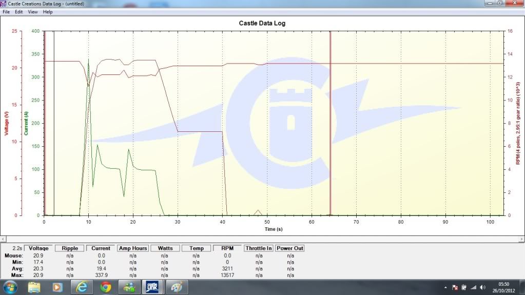

                            just done an aggressive spin up test on a full lipo;
                            337.9amps, 13517rpm.... this is gona end in a fire .... just goes to show how much more current you can pull through an automotive fuse then expected... bearing in mind theres a 100a fuse in there.
                            also its 390g over weight.... so ill probably change the baseplate for titanium, mill some pockets etc etc at some point.

                                337 amps?
                                Man now that's just silly.
