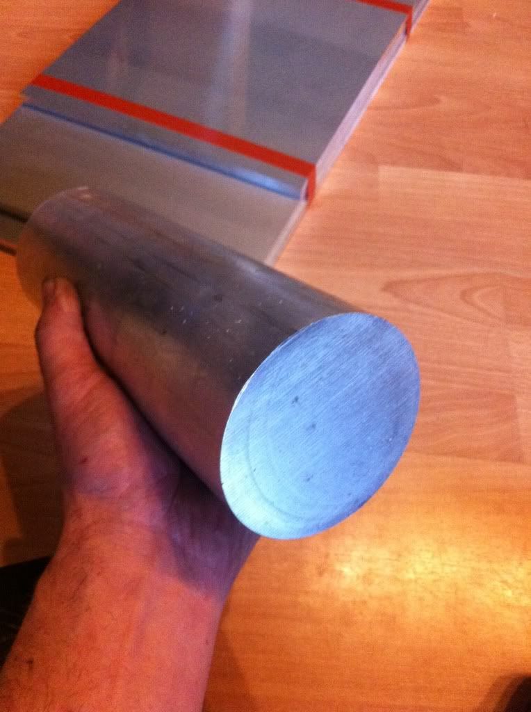

                              Material for my drum, in background is some more material to be used on some slightly more gay robots;
                              • Re: 360 - mini hypnodisc
                                Decided you cant have that material for drum now.
