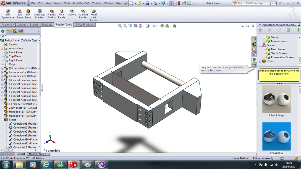

                          been playing with solid works thanks to dennis for sorting me out...
                          the render features are pretty cool... going to try get a pretty decent cad model of this robot before anything gets made.

                            galactus is looking good :P
                            sorry :sad: nah its awesome

                              the render features have definitely improved between the 2011 and 2012 versions
                              • Re: 360 - mini hypnodisc
                                Harry, Go back to your drill motors and chopping board.
                                Not seen much of the 2012 version... i think what ive done is a really bad example to what can be achieved, im pretty rubbish at CAD to be honest... a bit more practise needed
