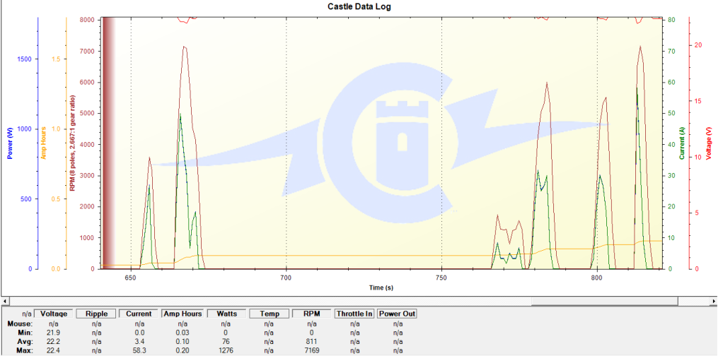

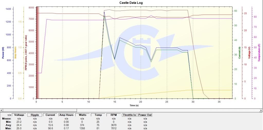

    just took the data off the logging system in the esc from the spinup in the video... came up like this;
    charged the lipo and did another test...
    spins up to 7812rpm in 1 second and pulls less then 60a that's gotta be a record?

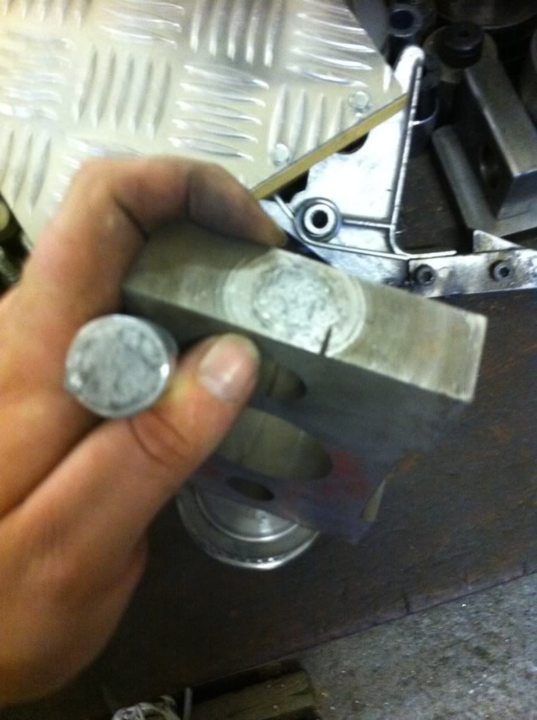

          material fail;
          i think what i got sold as D2.... wasnt D2
          this is how it did before it broke;

            Were the arms welded on, or has it just sheared straight through the metal? You'd think it would be up to more than that.

                Damn, that's crap :shock:
                Barely looks like solid steel at the point where's it's broken; looks more like some sort of cheap composite. Hope it didn't rob you of too much cash.

                  PJ- Yeah solid material... pretty lame how it sheered like that.

                    looks like a shear that you would expect from a stress concentration on a very hard metal. The metal is probably the grade of tool steel you were after. Had their been a larger radius to the shaft it may not have broken although it's a good demonstration as to why the hardest material isn't always the best.
                    • Re: 360 - mini hypnodisc
                      not a lot of load for 17mm tool steel... also its hard to machine a radius when your turnin a square bar round.
                        As we were saying it's pretty certain it's not a nice new peice of D2 that dave got sent as it should have been.
                        It almost looks very work hardened as if its a cheap tool steel thats been cut off the end of a used press tool or something thats done a few hundred thousand cycles lol. D2 is an excellent material - that beater isnt.

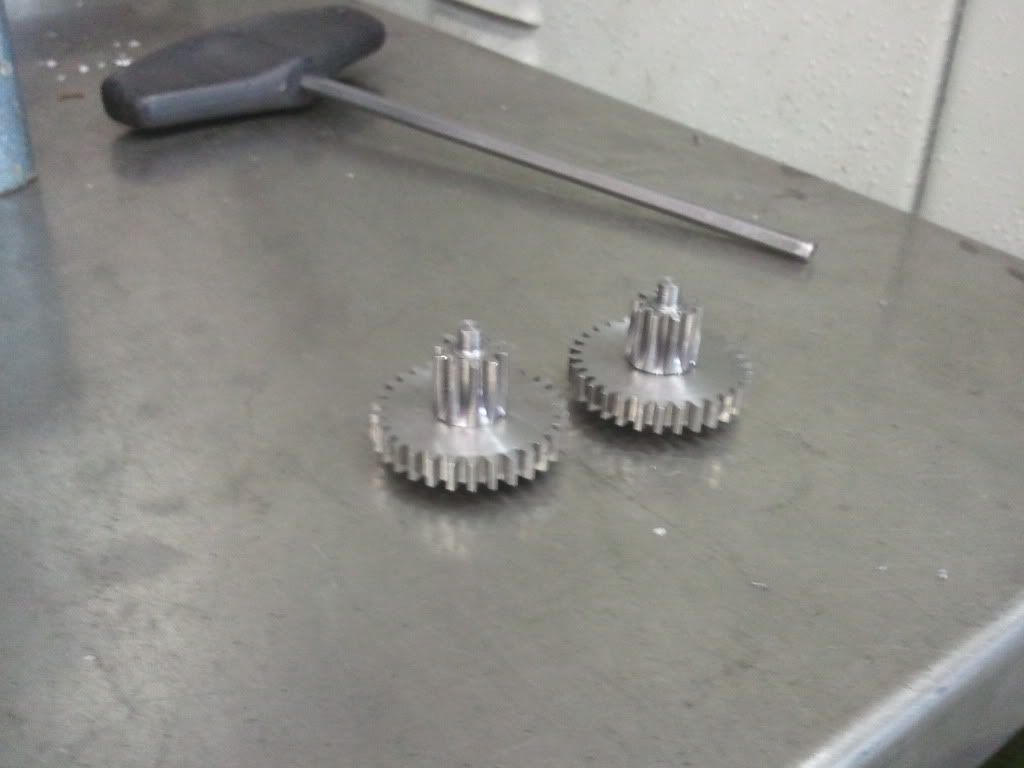

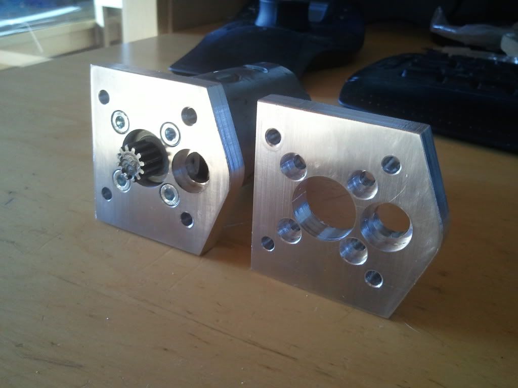

                            Dennis has done his bit on the gearbox's... hopefully ill have them in the next day or two, then i can make new output shafts for the main drive, and get them mounted in the robot... then it wont be as borring as it was at kidderminster.

                                looking really good Dave, whats the gear ratio on the speed 900's?
