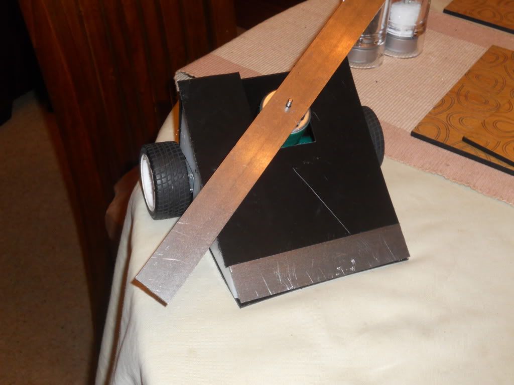

                      thats good news, just fineshed my spinner beetle this evening.
