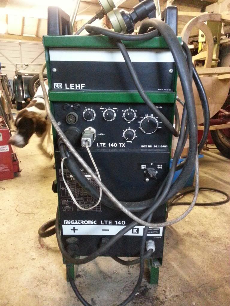

                      • #26
                        Anybody had any experience or know anything about the Migatronic LTD 140 TX TIG/ARC welder?
                        Looks fairly reasonable to me + I can get it for a decent price so might be worth a shot?
                        Cheers
                        • #27
                          ive used there mig sets before and they seem quite good
                          • #28
                            Migatronic is a good make, duel voltage as well.
                            • #29
                              Should more than do the business for a newbie
