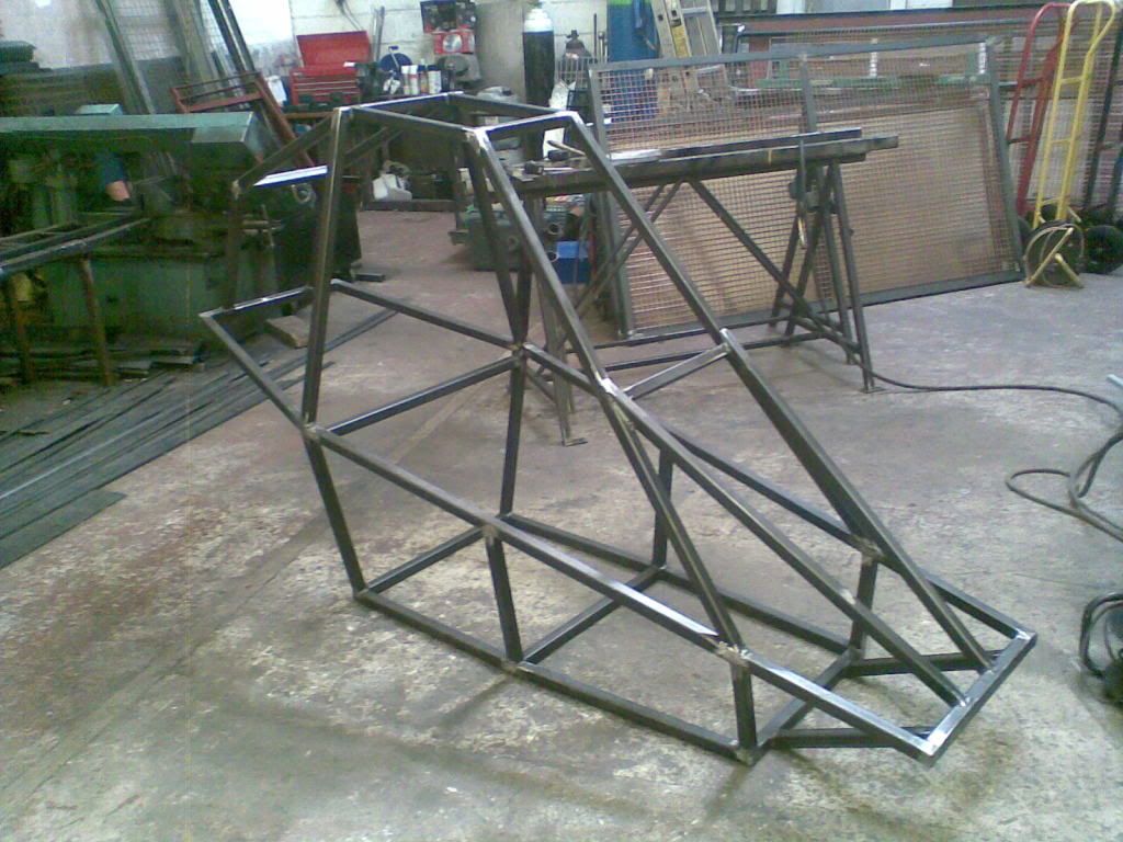

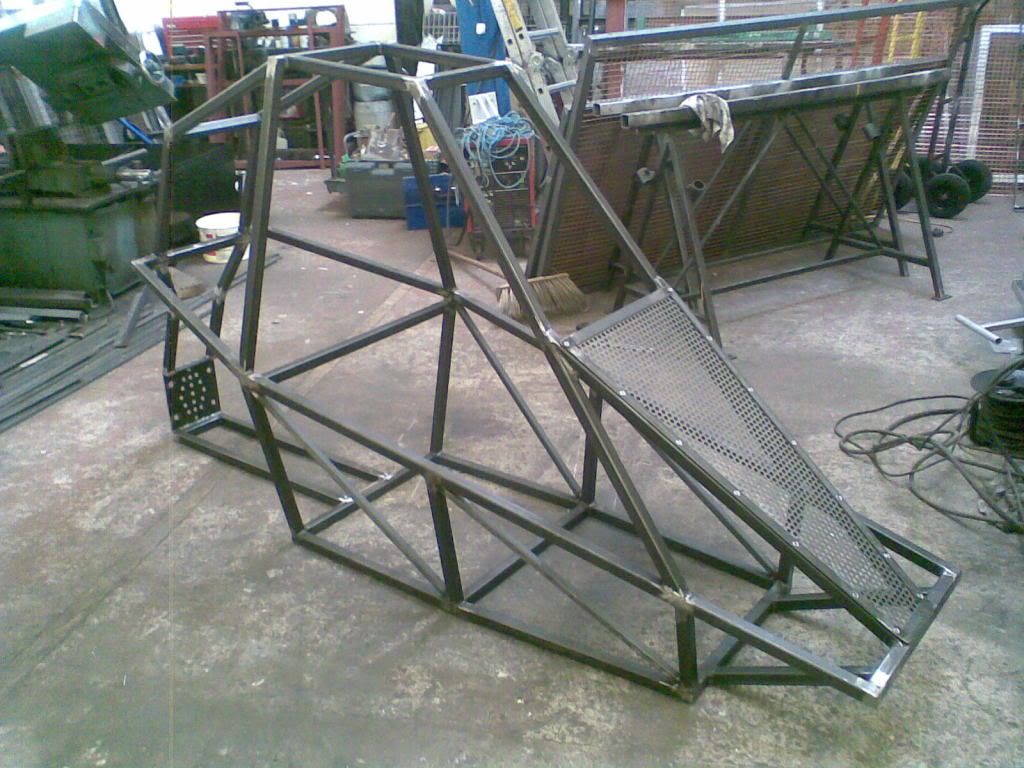

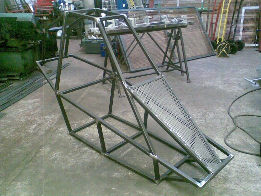

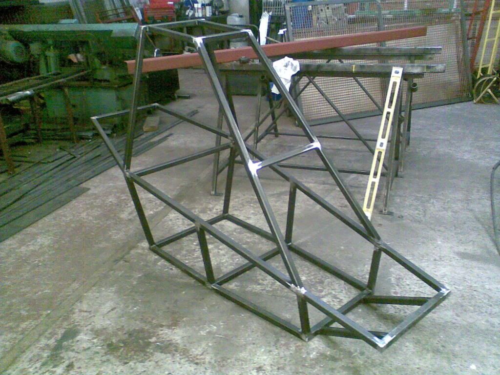

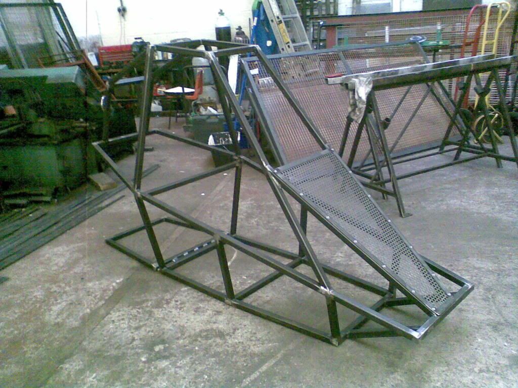

      The one I was building was very similar to that, Just a bit more compact.
      Ill upload some pics. kenny currently has the chassis in one of his units now, Ill try find some pics and upload them.

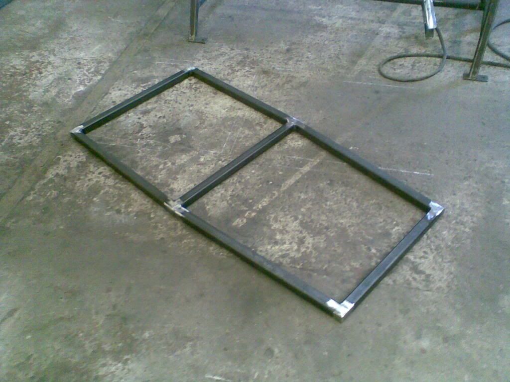

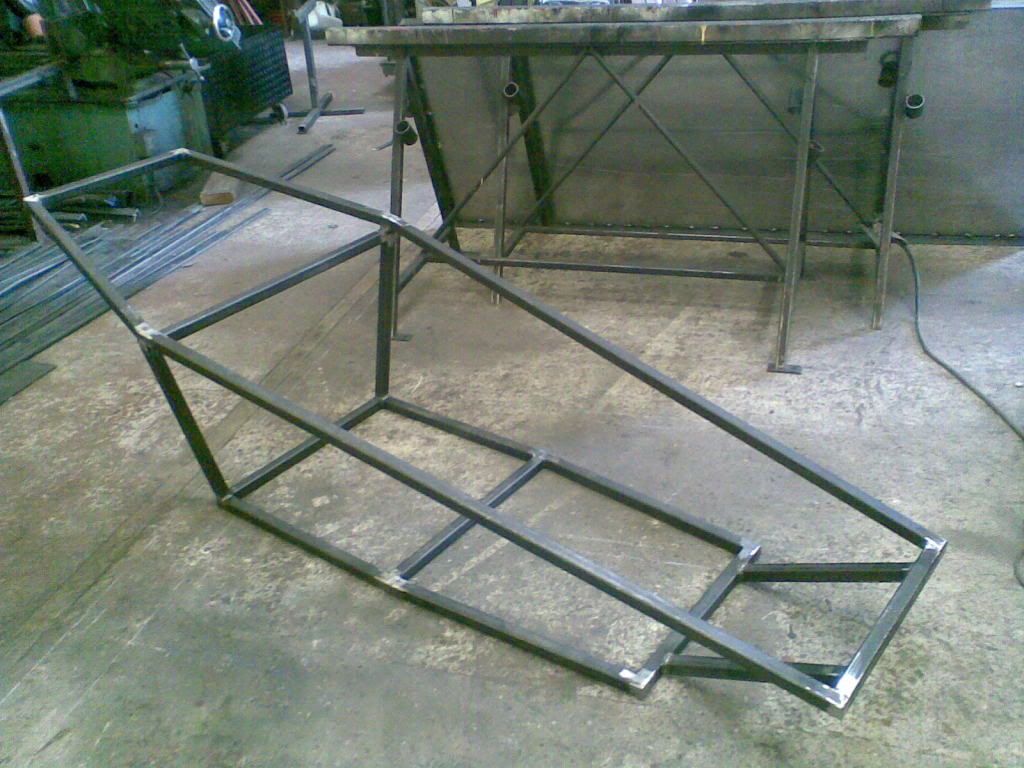

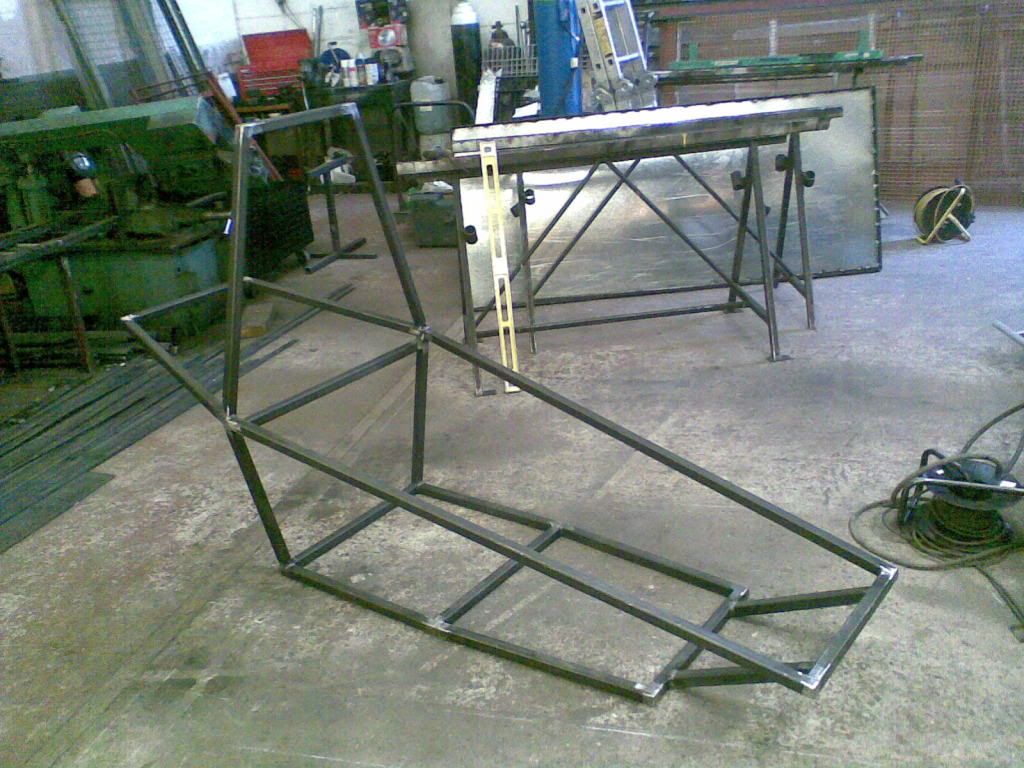

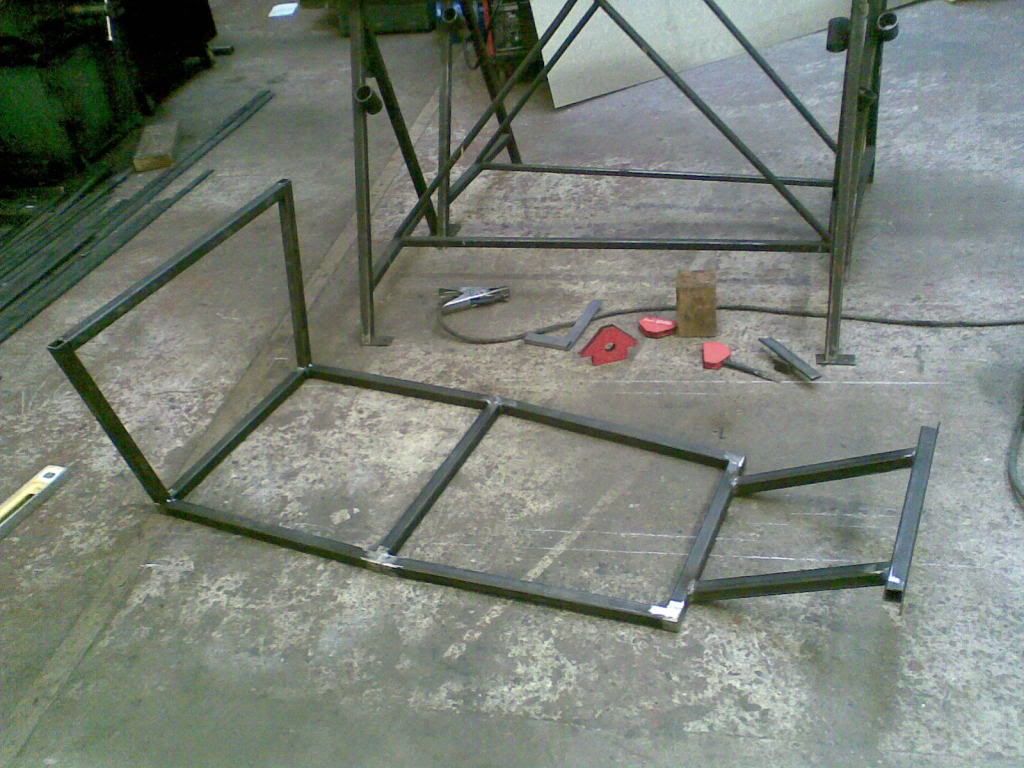

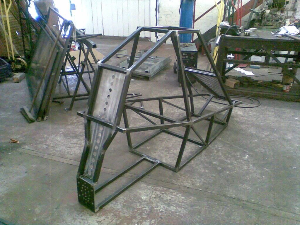

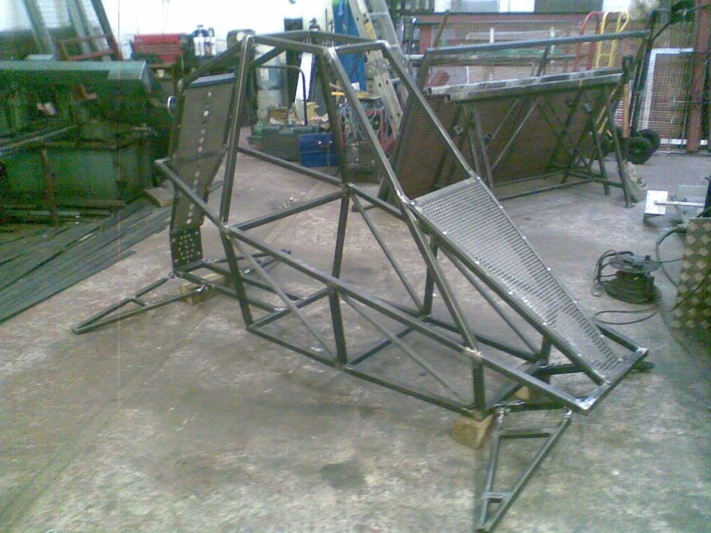

          Here I was going to have the engine and axle mounted in to a rear swing arm as one piece

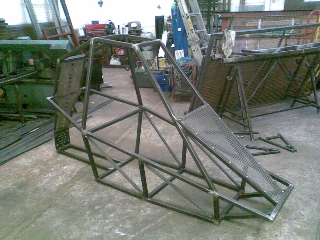

          But as you can see in the next few pics I changed the whole back end and decided to go for fully independent suspension
            Re: building a off road go kart
            Each suspension arm had a really long coilover shock absorbers so that each arm moved up and down independently. Alot better for off roading this way. Having axles solid mounted for off roading is no good, the rides really uncomfortable and you will find going over rough land your wheels will leave the ground and you wont go anywhere. having each arm independently mounted to a shock absorber the wheels are constanly being forced to the floor so you always have drive.
