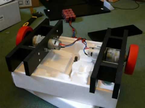

    Hi Dan
    We have had the same problem with them:
    We did get another one made but it was similarly as wobbly, however we have found that it doesn't affect the drive at all!
      I'd imagine that by driving the robot around on a Tarmac floor it should wear the wheels down so they are less off centre. Failing that just get a 3/8" unf bolt and screw the wheels into that, stick the bolt in a centre lathe and turn a bit off the wheels so theta re perfectly round.
      But to be honest I doubt it will be a huge problem if the wheels are a bit off centre.
