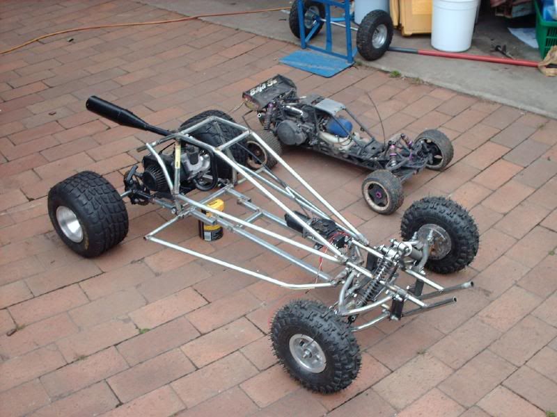

    Actualy, if you can find an old 1/4 scale car like this, you can go a long way.
    Onslaught , a real competitor in the heavyweight class, and demonstrated that car style steering isn't as nuts as some tought.
