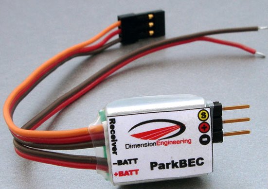

          So If I got one of these:
          and just wired the positive and negative up to the battery then I wouldn't need to connect the servo side up?
            Re: BEC circuits
            Yes you can. Wire + and - into the robots circuit, and plus the servo lead coming from the BEC into any spare rx channel. No need to plug a servo cable in the other end unless you need that channel for something. In Satanix its plugged into the rudder because that doesn't do anything on any bot the TX is used for.
