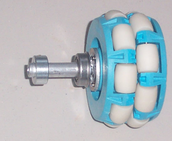

You can get omniwheels from RS, but they are only plastic and are only suitable for feathers - and would definitely not take a hit from anything spinning. I bought 2 pairs of 50mm to put in Mini Mighty Mouse, not got round to it yet though
Here is a link - http://uk.rs-online.com/web/search/sear ... &x=25&y=13

I wouldn't trust those 48mm ones. A loading of 50N (just under 5kg)? I wouldnt trust that one a featherweight even if you have them doubled up.
The 80mm ones doubled up might work well, a load of 250N each, doubled up and id be happy to run them (protected of course) in a feather
Re: omni wheels
They will not work unless they are paired, they lock together 60degrees apart and this gives a full smooth diameter. If you try one on it's own it will give you a lumpy ride.
The 2 pairs of 50mm I bought are well made but cannot comment on their strength as I have not used them yet, but as long as they are protected they should be suitable for a feather.
