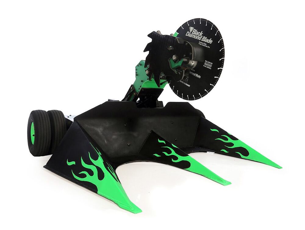

    The front will no longer be a standard wedge but a Season 3 Sawblaze tri-prong thing. This will be made out of cheap, nasty aluminium kickplate, the same stuff we used for the structure of original Harald that caused all signal sent from the transmitter to be blocked. This will hopefully be easy to work with, cheap to replace and nice and sharp on the ground. It should also help the weight distribution as they will reach further forwards than the wedge previously did. Speaking of weight distribution, the overall shape of the bot will be wider and thinner. The wheels will be placed at the back with all other components placed at the front. This should balance out the length of the weapon and mean the front prongs stay firmly on the ground at all times.
