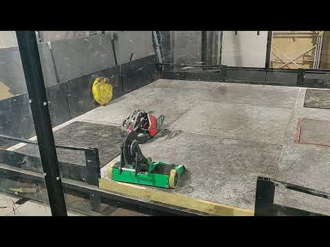

The Ogrelord Fight
As most may know, Sam Price makes some pretty good, destructive robots. With the allowed inclusion over overhead saws in sportsman for this year, we were all looking forward to finding out how destructive the weapon type could be.
This fight happened to be the one that the lifter failed. I got one lift in, reset the arm and it never moved again. This wasn’t the main event of this fight however due to the gourmet damage inflicted on FeatherDozer that was great to watch (probably). This is one of the fights that I unfortunately do not have recordings for, but the damage is clear to see.
As you can just see in the image above, Ogrelord just got to the ESC, but did not fully sever the power wires so it kept working.
Once it was clear that Ogrelord could go through Hardox with ease, Sam let off slightly (Ogrelord be scary).
Despite the damage and lack of a weapon, I manged to win a couple of fights and place 7th overall for the day which isn’t too bad considering.
