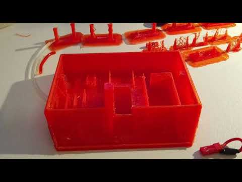

The overall chassis will be pretty similar to Gremlin, a 3D printed monocoque. Whilst 3D printed PLA is not exactly titanium, when printed as all one structure, the result is extremely rigid. I will augment this with some epoxy carbon fibre and we should be pretty nicely armoured at low mass!
