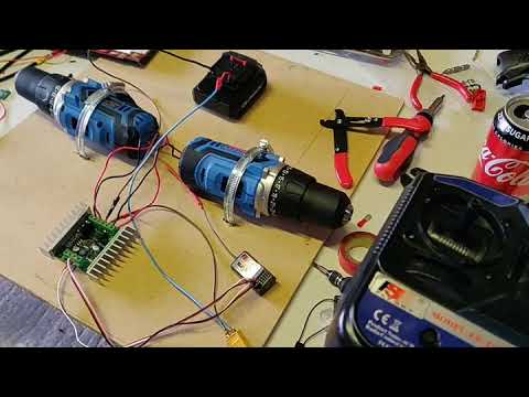

As a starting point I have 2x 18V drills from the majestic middle isle of the local Aldi, a Flysky FS-T4B transmitter and receiver, Sabertooth dual motor speed controller and all the other general bits listed in the Robot Wars Haynes manual (minus the weapon parts). Also, not to forget the Tesco own-brand four slice toaster, the star of the show.

So that's where I'm at! Building starts today, just trying to get the wiring and motors working on a piece of MDF before I actually attempt to build a working robot. Any feedback/assistance/encouragement would be appreciated!
