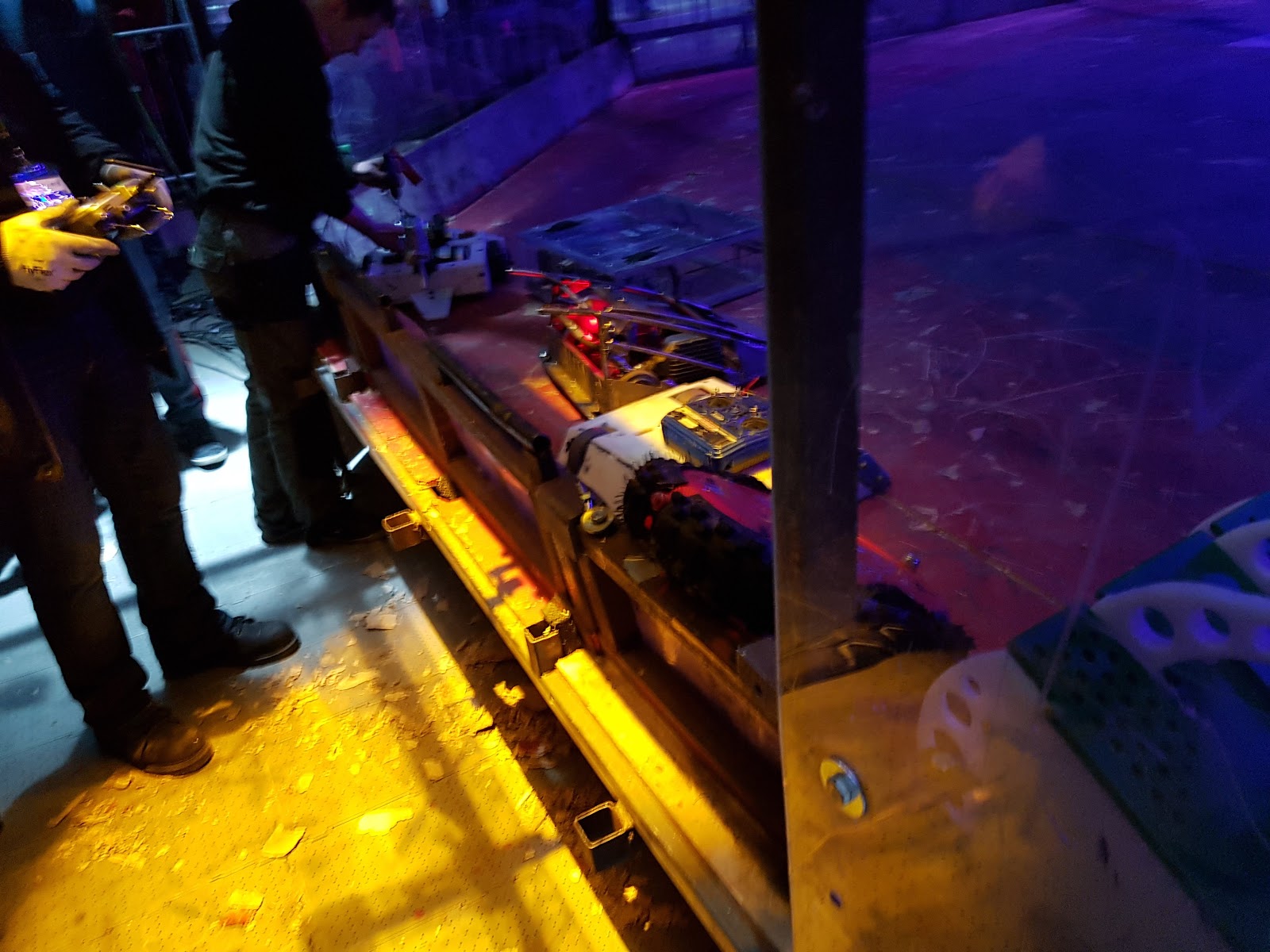

              A shot of the Arena the night before, looking uncharacteristically smooth. Rest of event report to follow soon.

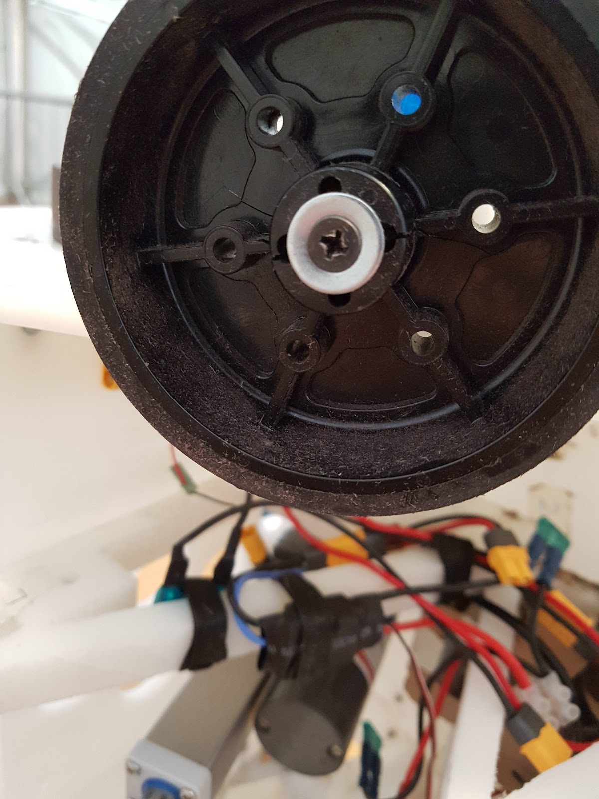

                The rear left wheel. It was not supposed to be spinning freely.
                DAY 2:
                My main focus for today was to figure out what was wrong with the rear wheel and to try to fix it. As you can see from the image below, there were several problems with the gearbox. The first were the visible cracks around where the ball bearings were (they were simply held in place by the tightened torque limiter as opposed to grub screws, I paid for this by losing a few bearings), clearly showing signs of stress. The second was that one of the metal pins that held the planetary gearbox on the inside together had slipped out, removing any contact the motor could make with the wheel. Fortunately, Team Node had written off on of their drill motors, and I was able to salvage the metal pins from it to restore functionality to the gearbox.

                  This day was a total rush, and 80% of this was all centered around getting working wheels, including such things as dismantling half the robot to get to the rear wheels (a real design fault). It's at this point that I need to explain how the wheels were mounted. They were hard plastic, tapped onto the shaft of the gearbox, and held on tight with the reverse-threaded screw and a washer. I thought that these would be the point of failure before anything else; in reality they worked too well. I was unable to screw the wheels off, as I had nowhere to grip onto the gearbox that would stop it spinning. This meant that the front motor brackets were stuck in between both the wheel and the broken gearboxes, and if I couldn't get those off, then I wouldn't be able to mount the new motors.
                  A shot of a wheel held in place by a reverse-threaded screw and a washer. Notice the crack as well.
                  In the end, I ended up having to cut open both gearboxes, and use a vice grips on the inside of them to finally, slowly, remove the wheels. After dismantling both drills, the soldering of new connectors, and the dismantlement of the entire machine, followed by reattaching the wheels and rebuilding the machine again, I didn't even have enough time to hammer the steel front strip back in place, and so opted to use the replacement one instead. I also used zip ties across the metal pins so that they wouldn't fall out this time. I tested everything and was back to being fully operational in the nick of time.

                  The main thing I was interested in was to find out how I had lost a wheel early on. As it turned out, I had simply forgotten to re-insert the reverse-threaded screw which held the wheel in place, and as a result the wheel came loose. It still supported the machine from dragging on its corner, but the threads were completely shattered as a result. I also took far more damage this time as well thanks to Tilly Pecker, which left marks mostly in between the two front grabbers and at the back-right corner of the main face.

                  • I was pondering for a while how to get wheels off of the gearbox shafts, even thinking of cutting a slit down the center of them to allow for a flathead screwdriver to grip. It was only after the event that I realised I could just run the motors while holding the wheels, and they'd just screw off that way. Oops, knowing that could have saved me some money in broken gearboxes! I now have a setup for doing just that using a scrap piece of HDPE.

                          Some observations from this fight:
                          • While driving into the arena, I noticed the new transmitter wasn't identical to my old one. In fact, the mixing was reversed on it, so while forward was still forward and vice versa for reverse, holding left made the machine turn right, and vice-versa. It was still fully driveable, but definitely tougher to do so.
                          • As the fight starts, I notice that Barróg also starts spinning at random intervals, which was a sign that something was definitely wrong.
                          • After a minute of doing sod all, I end up in the center of the arena, where something explodes within Barróg, a puff of smoke comes out, and it is dead, full stop. Luckily, I get shoved into the corner before too much damage is caused to the machine.

                          A shot of the toasted ESC. unknown if it would still work should I replace the BEC wire (I hope so)

                          • BEC's will be altered so that only one powers the receiver, possibly one of the drive ESC's. I'm going to give the linac ESC makers one more chance, and place the fuse before the ESC instead of after from now on. Botbitz ESC's are high on my shopping list now.
                          • While in Dublin gearboxes were the ones giving me trouble, it seems like the wheels gave me more to keep an eye on in Manchester. They hold for most of the fight, but start to come loose in the later half. I've gotten a few hex nuts now along with a wheel they slide into, but still need a way to secure the nut to the wheel. 50/50 on whether to stick with tapped plastic wheels or to transfer to nut-mounted wheels.
