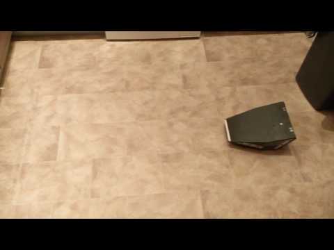

    So further progress made - it now has a chassis! The ESC is still being worked upon, the first design ran far too hot and I didn't lay it out in a way that heatsinks could be added easily.
      Looks nice, whats the chassis made out of?
        This is looking great for a first beetle build! I imagine you'll want to get your wedge properly scraping the ground at some point though, the wedge war is rife. Look forward to seeing your custom ESCs!
        Also welcome to the community of Craig's in the UK scene! Fortunately unlike me you've chosen a sensible username so everyone won't think you're someone else whenever you post anywhere... (sobs uncontrollably)
          The chassis is made from uPVC. It's unlikely it would last long but it is quite light. The robot weighs in at 1.4Kg currently so has to shed some weight before anything like flipper mechanics are added.
          It's very much in the prototyping stages to see what works at the moment!
            Could probably add a thin steel plate to the end of the wedge to improve ground clearance and add some strength if needed
              This is looking like a great first build, nice and simple and an effective design if done right.
              One thing i will say though your PVC chassis will not last very long against spinners, it's too brittle. If you're using any type of plastic i'd always suggest using HDPE sheet, it's easy to work with and will take spinner hits all day long.
                Agreed, I will take the advice and upgrade it to HDPE / Polycarb before taking it into battle! I like to work with real prototypes hence building this to work on. I can start to fiddle and tweak the other parts.
                Plus it gives me the ability to learn how to drive it!
