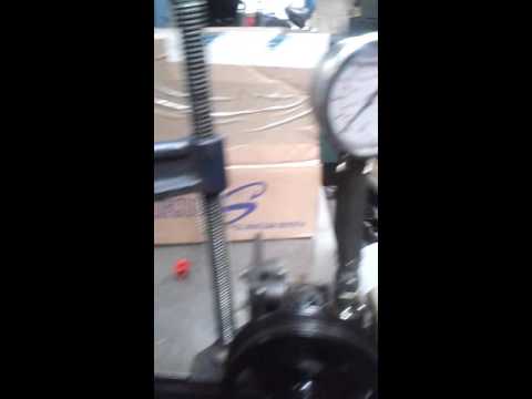

little update on mooch.
improvised a jig to hold the pump still.
connected an 18v cordless drill to it and saw regular 900-1000 psi readings over 3 goes.
means i should have 12560 pounds force from my ram less say 15 % for mechanical losses = 10676lbs
good start i think
