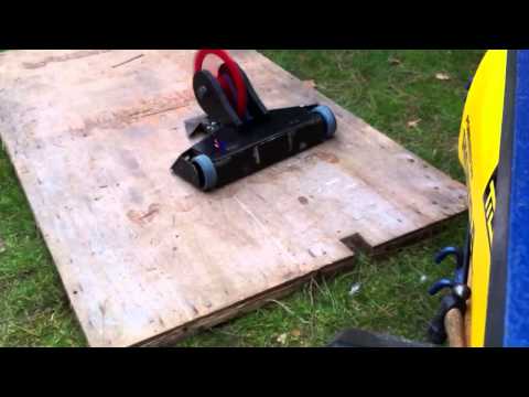

    The rebuild is under way now with the following changes
    New drive system (speed 900s instead of drills)
    Sidewinder speedo instead of Scorpion
    8s A123's (replacing 24v Ni-Mh's)
    New bulkheads with bearings (old system ran directly on the HDPE bulkheads)
    There are a couple of other minor bits but it is all taking shape nicely
    Testing to see if the new drive setup would fit
    The new disc mechanism- still need to fit the 2nd speed 900
    The new setup in place

    Inertia has had some work done on it today. The new disc mech has been finished and attached to the base. The new ratio seems to be way better when run off the old 24v Ni-Mh pack so should be even better on the 8s A123s.
    After having a good think I decided to ditch to speed 900 drive system in favour of a couple of Gimsons which freed up more weight for even more armour and a new reinforced front scoop. Tomorrow I will fit the drive and armour, wire it all up and give it a test.

      Why did you take the Speed 900's out of Inertia? She also seems to be like 100mm longer? Wont that make steering even more difficult?
        Re: Inertia XL
        Weight was going to be very tight and I decided to keep the Hardox instead as it didn't really need the s900s. This version is only 30mm longer than the first one, this was so that the sidewinder would fit into the rear section. It probably looks longer due to the sloped back end.

                  Nearly finished Inertia now. Got it wired up last night- just the top panel to fit and a few mounting bits and its good to go in the arena- might even have time to paint it. The weight without the lid is 12.9 kg so I'm pretty happy with that
                    It works Final weight is 13.4 kg and just needs a coat of paint to finish it.

                            While I'm here I may as well post about Inertia and the changes I'm thinking of for next year.
                            Everything still works in the current version although there are some improvements that could be made.
                            1. Redesign the front end as the scoop was bent by 720.
                            2. A new, heavier disc. Going for a 3kg single tooth with the same design as my Antweight- will be using the current one as a backup.
                            3. Might have to finally go brushless. This would free up loads of weight to complete the Hardox top panel.
                            4. Swap from A123s to Lipo- 6s means I can go back to the scorpion XL speedo for the drive freeing up yet more space and weight in the robot.
