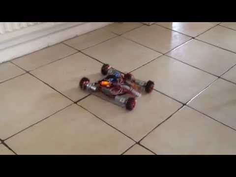

Why mecanum wheels? I would've thought either a 3-motor setup with 3 omni wheels, or a 2-motor setup with 2 omni wheels each, would be much more suitable for this sort of thing. I'm not sure mecanum wheels will work properly, if at all, on a non-flat surface, and I'd certainly expect the movement to be less smooth than with omni wheels.
Team Saint Robot Builds
 Hi Scott
 The best part about this project is I have not done anything like this before, and I don't know what will work.
 After receiving the wheels I am thinking the same thing, and I might go for the 3 wheel setup. later

 Some pictures of the parts used in the omni wheel test chassis, just in case anyone wants to make one. I have had a lot of fun driving this mad bit of kit I would recommend it. setting up the mixer was not difficult either.
 IMG_1098[1].jpg IMG_1099[1].jpg IMG_1100[1].jpgIMG_1102[1].jpg IMG_1103[1].jpg IMG_1097[2].jpg
