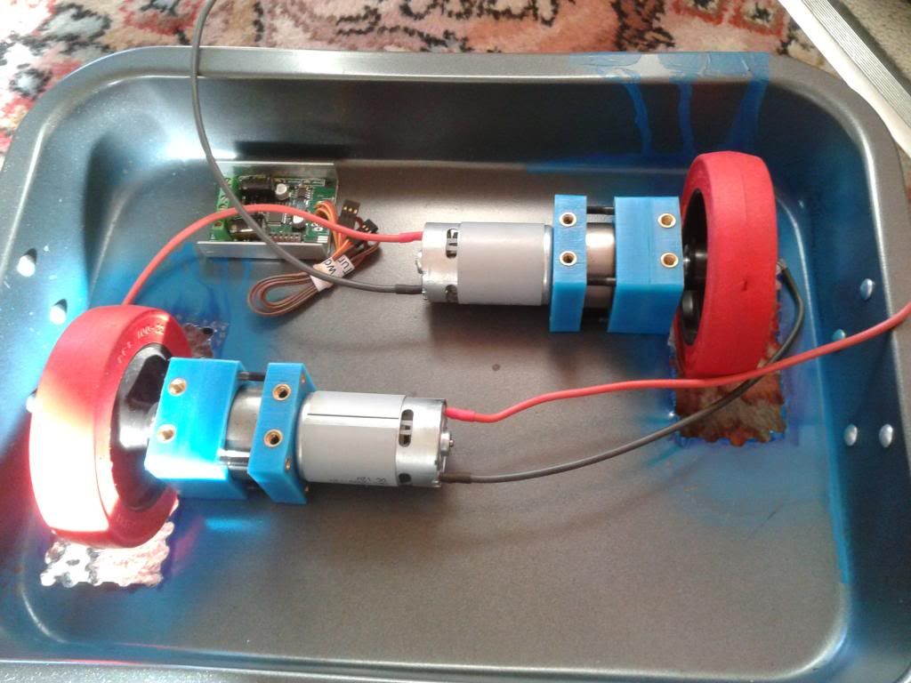

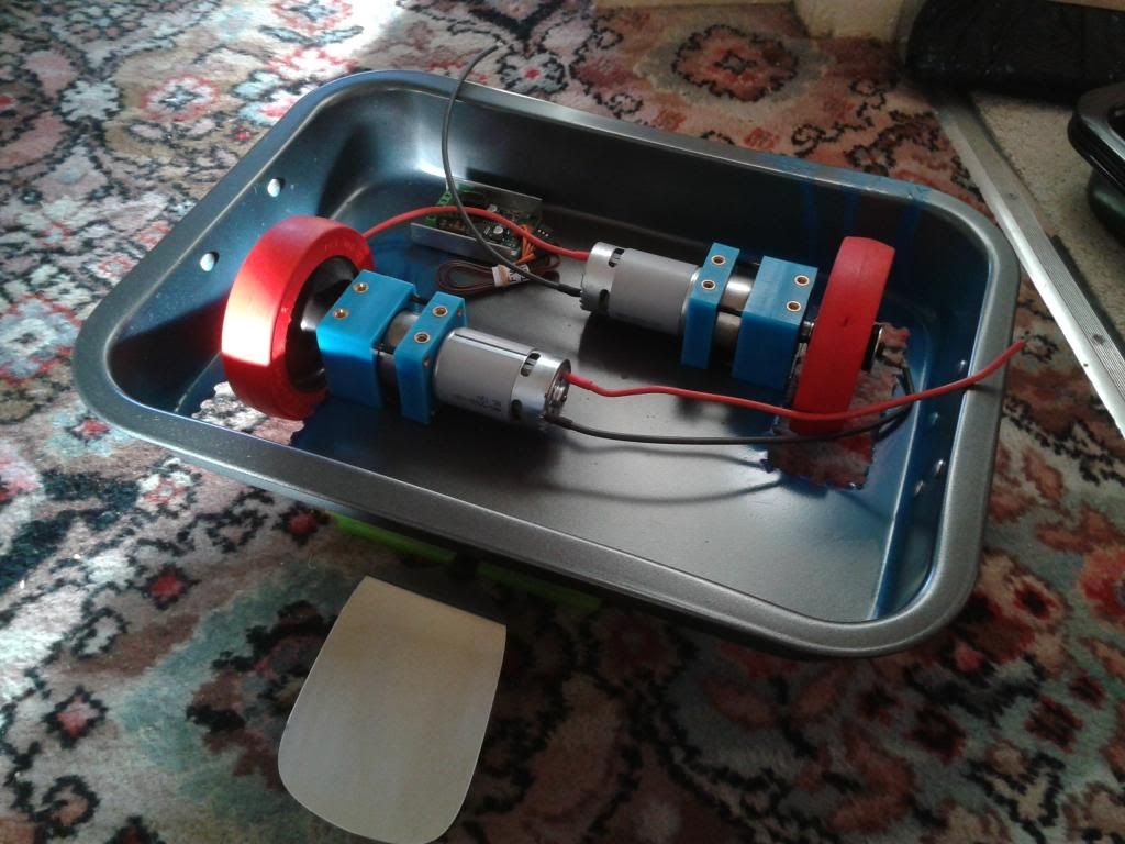

            More progress this week with some pictures. Below can be seen the robot now incorporating the Sabertooth and new weapon the Spatulator. The basic gist is that the Rx and ESC will sit in the back corner shock mounted and with an extra layer of protection around them as they've been the expensive bit. Then in the opposite corner at the front will sit the battery pack that's on it's way in a home made holder. There may also be a chock block somewhere as a distribution for cabling etc depending on how tidy I manage to make it. Also to note is that one side wall will be receiving an LED and Link soon. Two pieces of angle ally are also being cut and bolted to the front and back walls to form the mounting for the lid to bolt to.

              The robot looks great, whwn you have finished it would be interesting to see how good that sabertooth is as i was debating to use one in the robot i am currently building but chose the slightly more expensive scorpions. The robot looks good. Keep up the good work and i would love to see this moving.

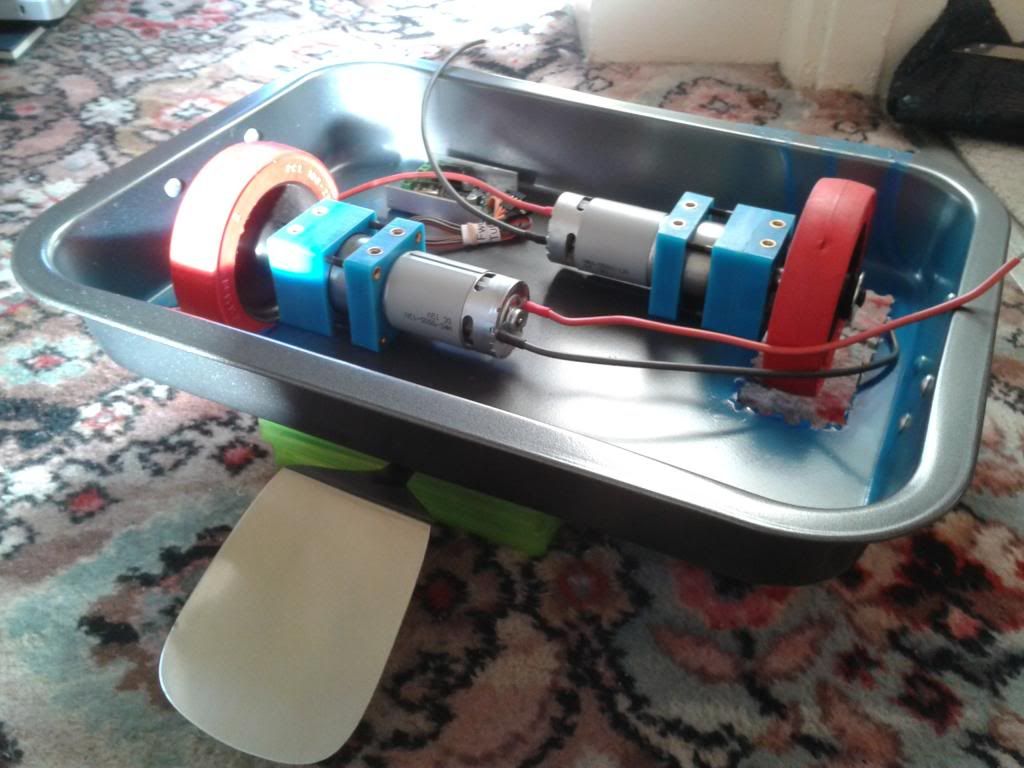

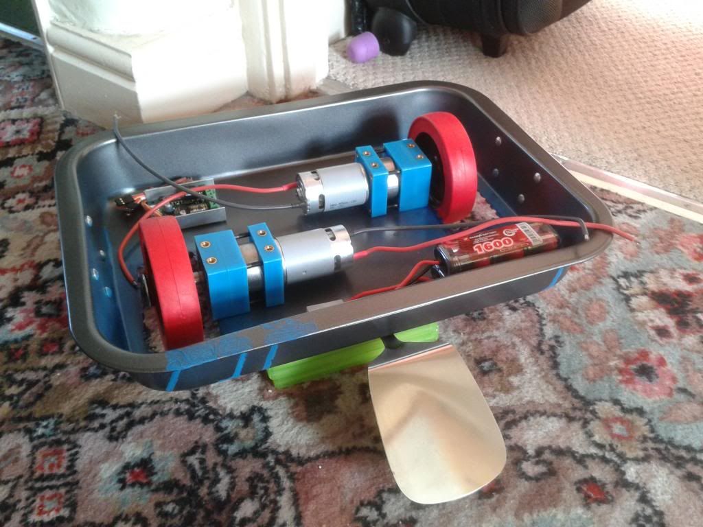

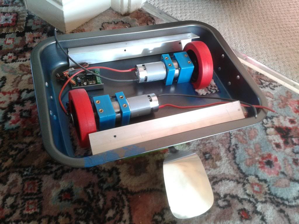

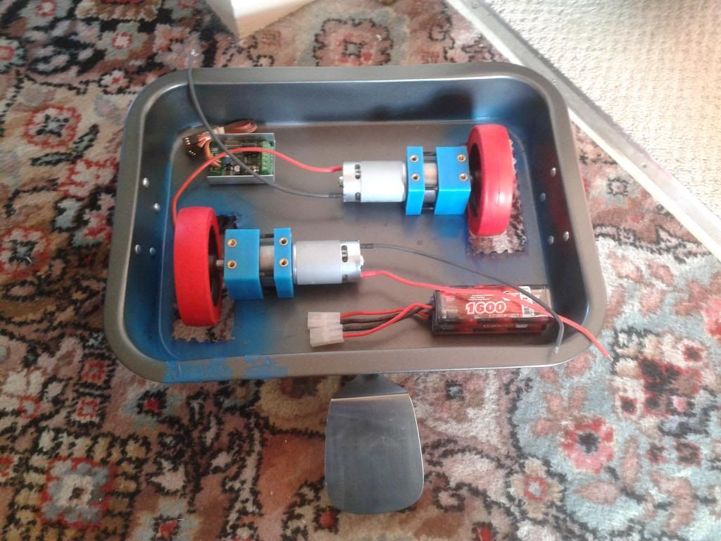

                                Some other bits got done over the weekend so I thought I'd stick some pictures up. You can see the battery in the corner now, and in the later pictures the angle ally that will hold the lid on. All in weight at the minute is 4kg so I'm on target for the cluster bot I'm looking to build lol. At the minute I like the idea of the Saucepan of Doom or the Pressure Cooker of Doom. I'm also entertaining ideas for the Wok of Doom.
                                From the batty workshops of Team Smoothie! please enjoy lol.

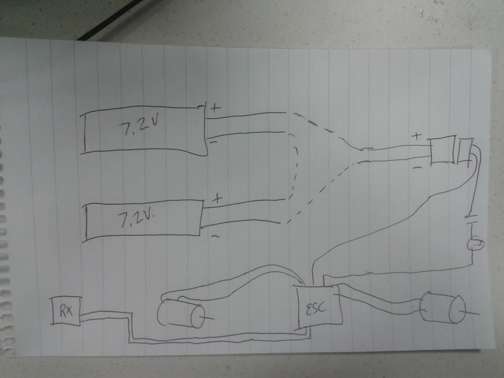

                                Edit: I also thought that putting up the basic wiring diagram might also help folks out if they ever stumble across this and are looking to do anything similar to the way we've done it.
