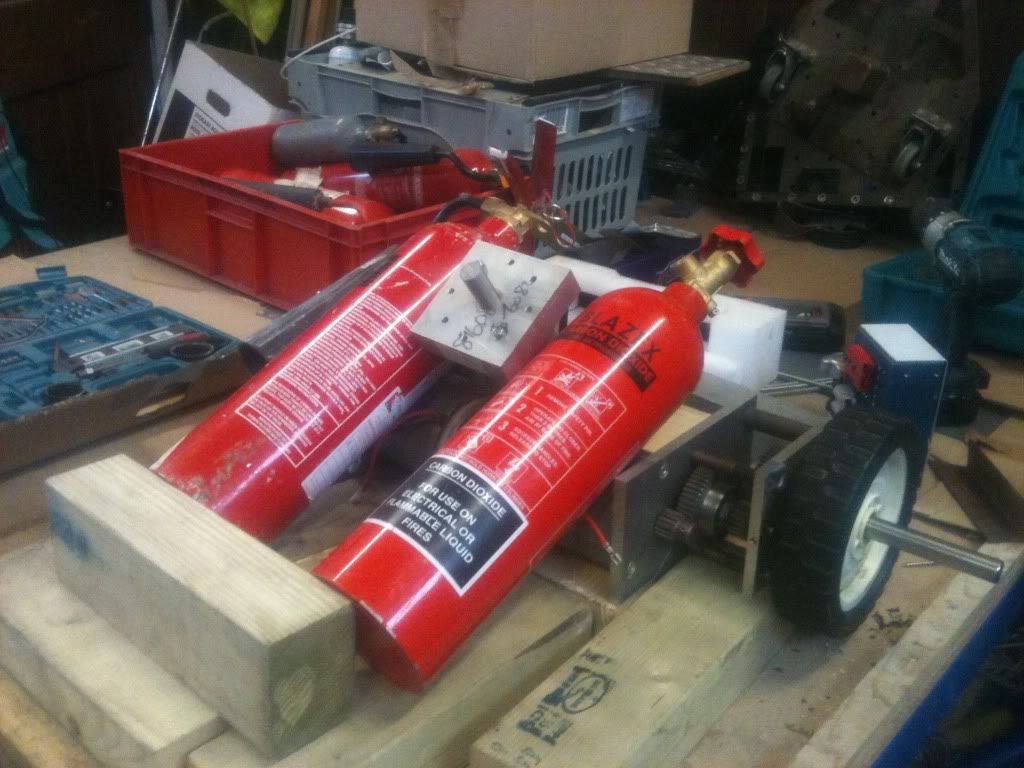

                          • Heavyweight has been slowly coming together:
                            I've made an aluminium angle frame and a 5mm steel base. I'm hoping to get 4 mm steel armour cut out- it should give a lot more strength to the frame.
                            Still on the search for 8-10" wheels so if anyone's got some please let me know.
                            • Ive got a spare set of kart hubs that can fit tyers I have? Also got the tubes and both the tyers and tubes are unused, the hubs are scratched but fine if you are interested? once inflated are 10 inch, same as on Bulldog Breed
                              • Sounds good, how do they attach to the shafts coming out my gearbox? Also how much do you want for them? Cheers.
