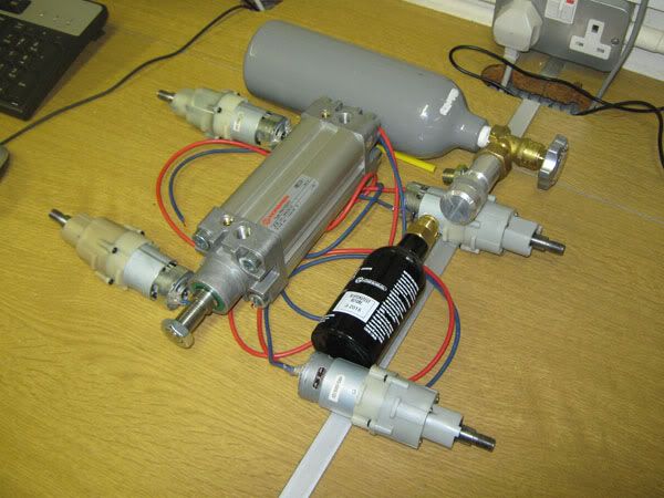

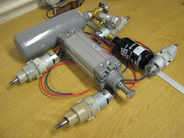

    For my As level resistant materials I am building a featherweight (mainly because they have a welder and free steel.). Though Since I only get one shot at building a featherweight I will be starting with a more ambitious robot of a 4 bar pneumatic Flipper. I have built quite a few smaller antweights so I have some experience except for the pneumatics.
    I have picked up quite a few of the parts already:
    600g CO2 tank
    4oz CO2 Tank (a very small buffer)
    4 Drill Motors (already locked the clutches)
    Trevor Regulator
    16bar 50mm Bore 80mm Stroke Pneumatic ram
    Spektrum DX6i
    I plan on running it with electronise 30A speed controllers, a 4cell lipo (14.4v) and a spektrum receiver (not the cheap hobbyking ones). The Ram is double Acting And I think I will use it that way despite the fact it uses more CO2.
    The chassis will bemostly 8mm HDPE (on order) reinforced with steel and a steel flipper frame (bolted and welded). Some 75mm Robochallenge blue wheels for the drills and it should be good to go.
    I have some pictures of the rough layout here:

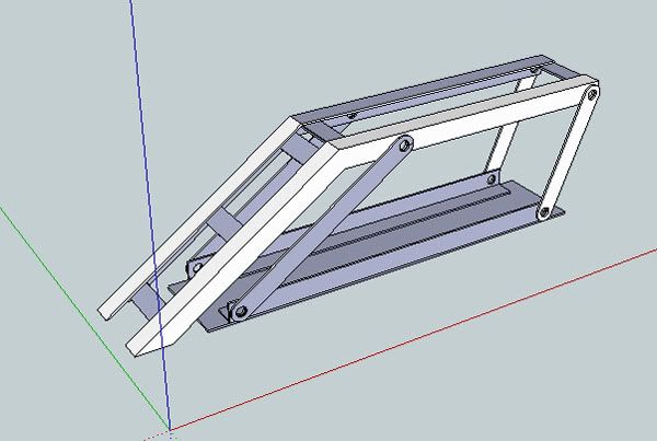

    This is a quick CAD of the flipper I am working on. The flipper it self has a tip travel of 240mm, with the ram at 16bar it should be okay for flipping.
    The only difficulty at the moment is 16 bar fittings and trying to fit the 4OZ cylinder onto the system ( I will remove the pin valve eventually).

    This looks fantastic. It will be great to see a 4 bar flipper, their forwards and upwards motion is superior (in my opinion) to rear and front hinged weapons. I shall be observing carefully as progress is made!
      Re: Team Shakey Build Diary- Featherweight
      Are you planning to power the front bars or the back bars ?

          I am planning to power the front bars so the ram can sit inside it and because it has more power extending then when retracting.
          The CO2 bottle was from roaming robots if I remember correctly. 4 Bar flippers are very nice to watch I think, my inspiration came from the american super heavyweight named Ziggy.
