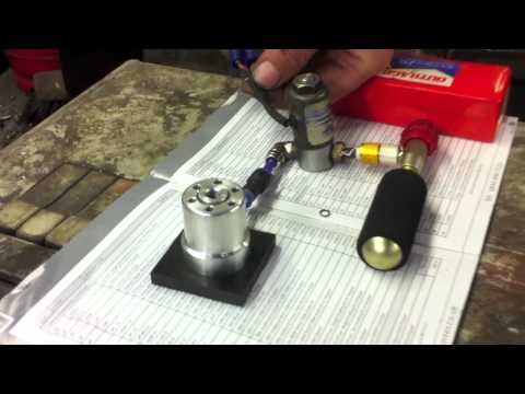

              Okay, I'm still keen on the pneumatics idea, and I've managed to find a video showing the pneumatic system inside Flange:
              It looks like a custom made ram, a solenoid and a CO2 catridge with a few connecting pipes and nothing else (please correct me if I am wrong); does anyone know where I could buy a ram and a solenoid capable of handling full pressure from a CO2 cartridge at full pressure?
