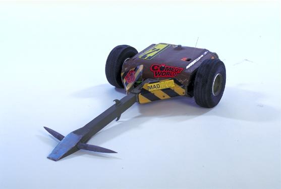

                    Just expanding on that idea, I'd like to see how this design would work:
                    This has five weapons in one: the weight itself, a spear point for stabbing and wedging and points on the back of the spear for grappling and pulling. Finally, the arm can be used as a keep-away stick against spinners. The single arm allows it to work vertically or horizontally.
