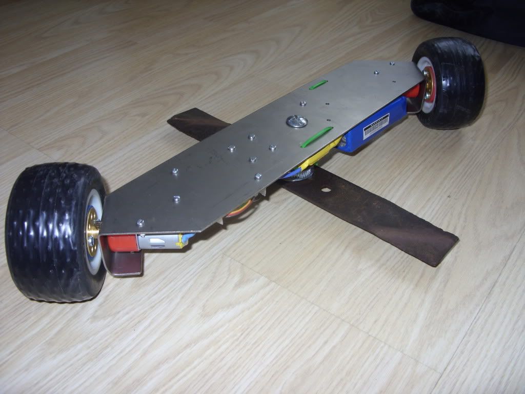

    A couple of photos with the cover off (since it doesn't look very good!)
    RIght way up;
    And upside down;
    Also had a weigh in and it's 110g over weight, so that's the next thing to deal with. Also found a couple of nasty cracks in the blade, so looking to replace that before it breaks off if anyone has an old lawnmower kicking about?
      use a smaller battery, I'm only using a 11.1v 1000mah lipo.
      also for the blade have a look at flymo blades.
        You could be right there, 2200Mah lasts quite a while.
          Also you'd probably be better off making your own possibly lighter blade, lawn mower cutters aren't exactly designed for this kind of use...
            But that's not very Bitza!
              But it isn't bitza is it
