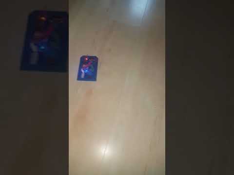

After the traditional set of initial failed prints, the thing eventually came out quite nicely. Just meets the weight spec. The frame is rather tough too, feels very rigid. All assembled fine, although screwing in the motors was fiddly due to the overhanging wedge. It is definitely worth the effort to do the wiring before screwing stuff in for an antweight, they are tiny and fiddly, and PLA is a bit melty when exposed to solder!
Fully wired up she works just fine. Quite happy with the handling etc, I might even put the lid on when I fight!
