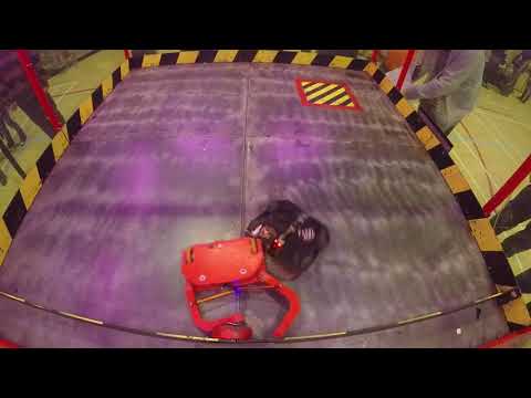

This was the first meeting of SCD and Sir lance-a-frog, which as you'll see, becomes a bit of a theme!
Video of the first fight against Snappy (Skip to 1:26)

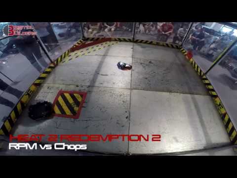

This was the first outing of Mark 2, and as a result of the changes, it did much, much better! The direct-drive mode was still a bit wonky, and the translation speed needed upping a notch as it was quite slow, but otherwise, it worked correctly.
Though it didn't get far in the competition, it won the Gladiator by judges / audience decision, and was given the Best New Entry award!
My favourite fight of the event was against Sir lance-a-frog (spot a theme emerging here?)
